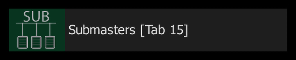

Submasters [Tab 15]
This display shows a list of all submasters. Submasters can store any parameter data for channels. When storing from Live, Record Only and Record can both be used to determine what contents are stored. You can copy cues, presets, or palettes to a submaster as well.
Submasters can be opened in a standalone tab from the Workspace Layout Menu or by using [Tab] & [1][5].
